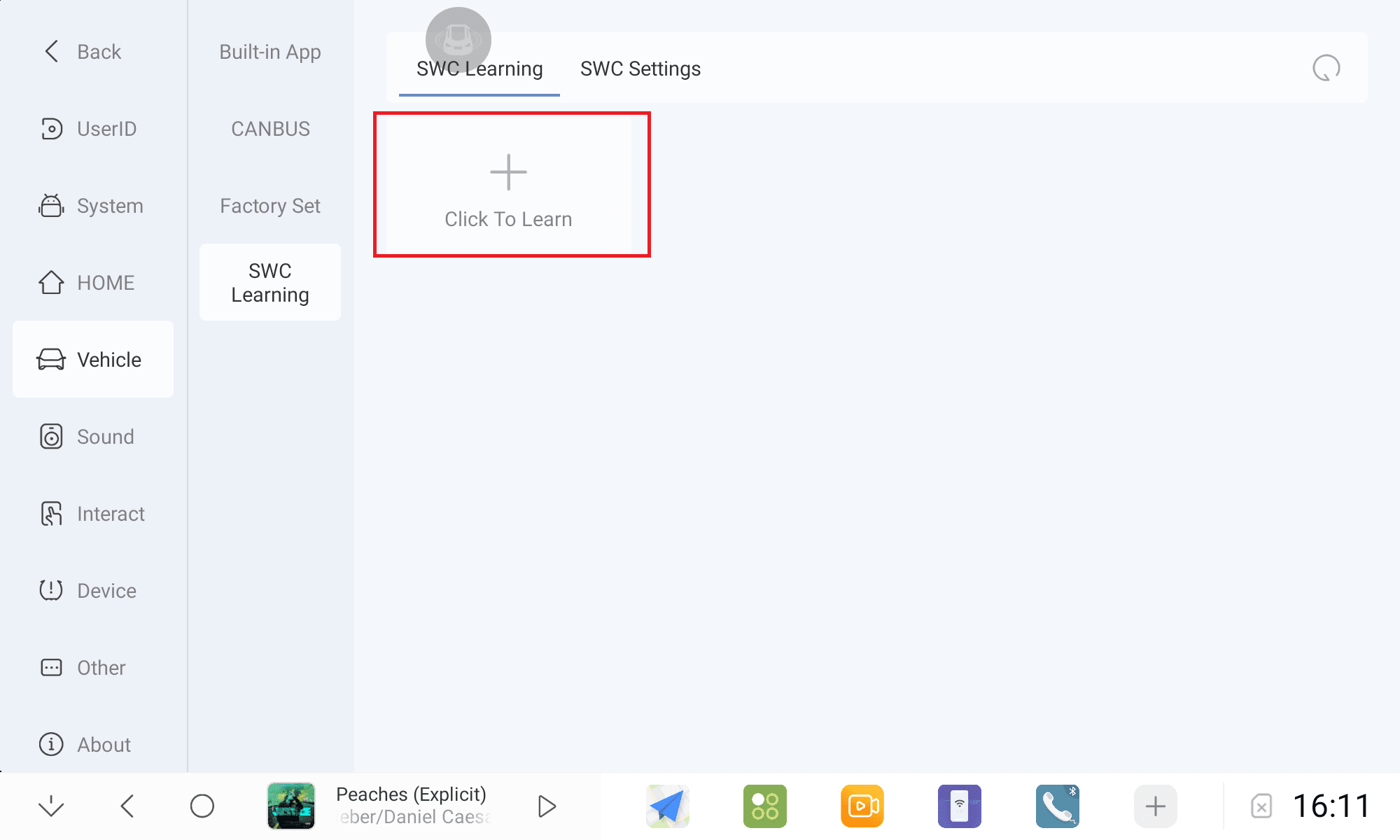

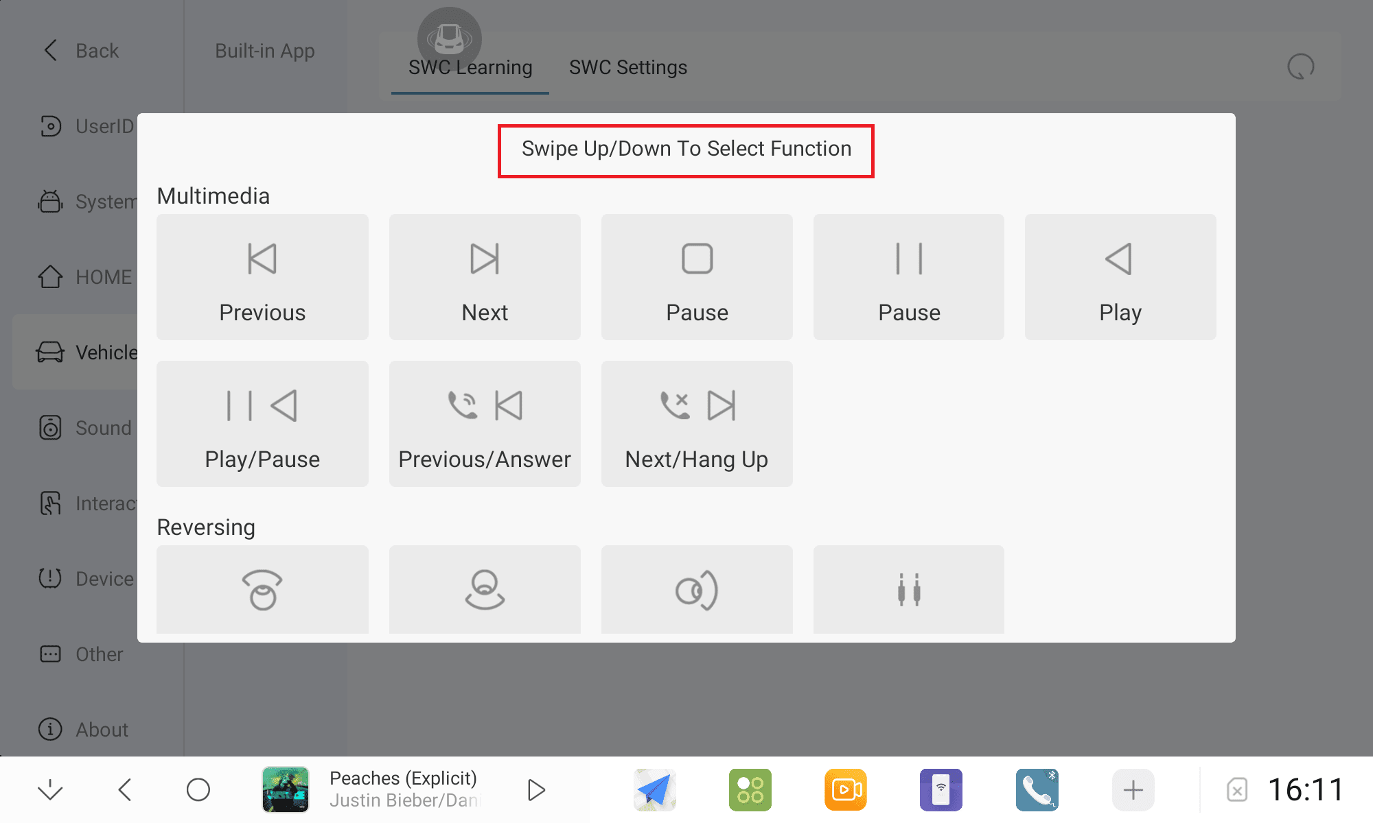

Vehicle protocol selection SWC learning
.png)

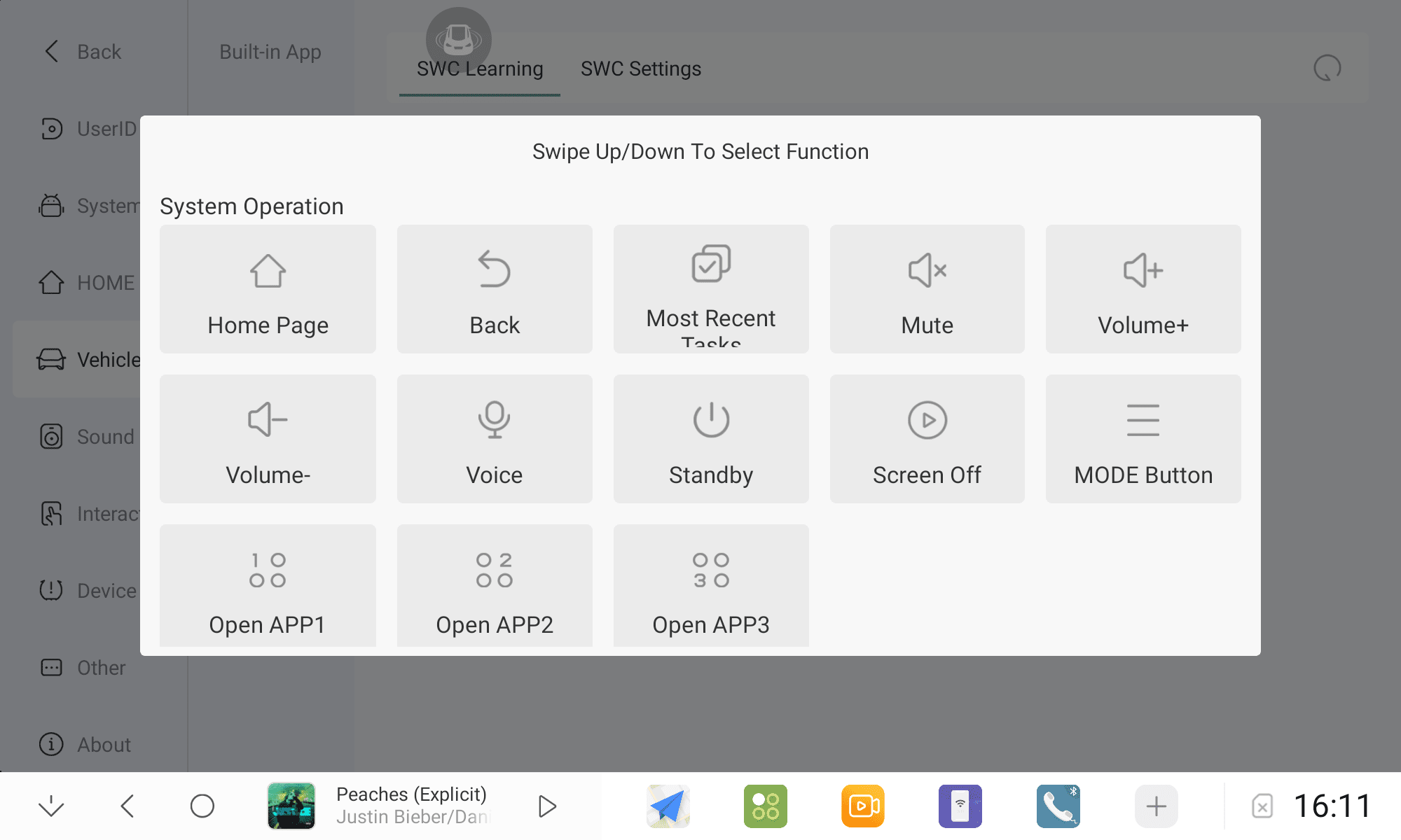

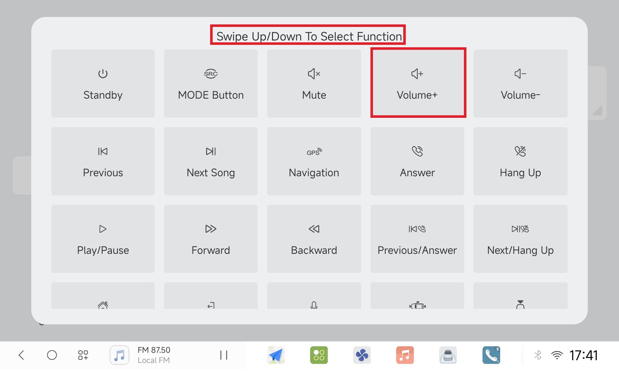

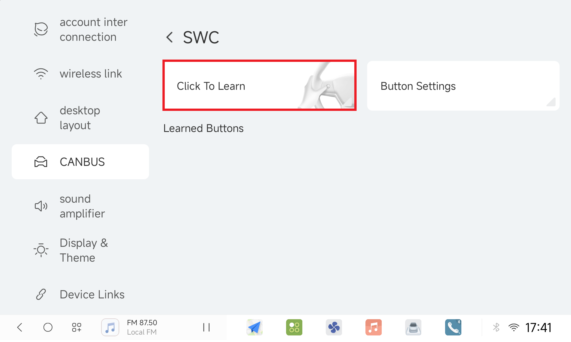

Click to learn, you can slide up and down to support learning multiple functions
.png)
.png)

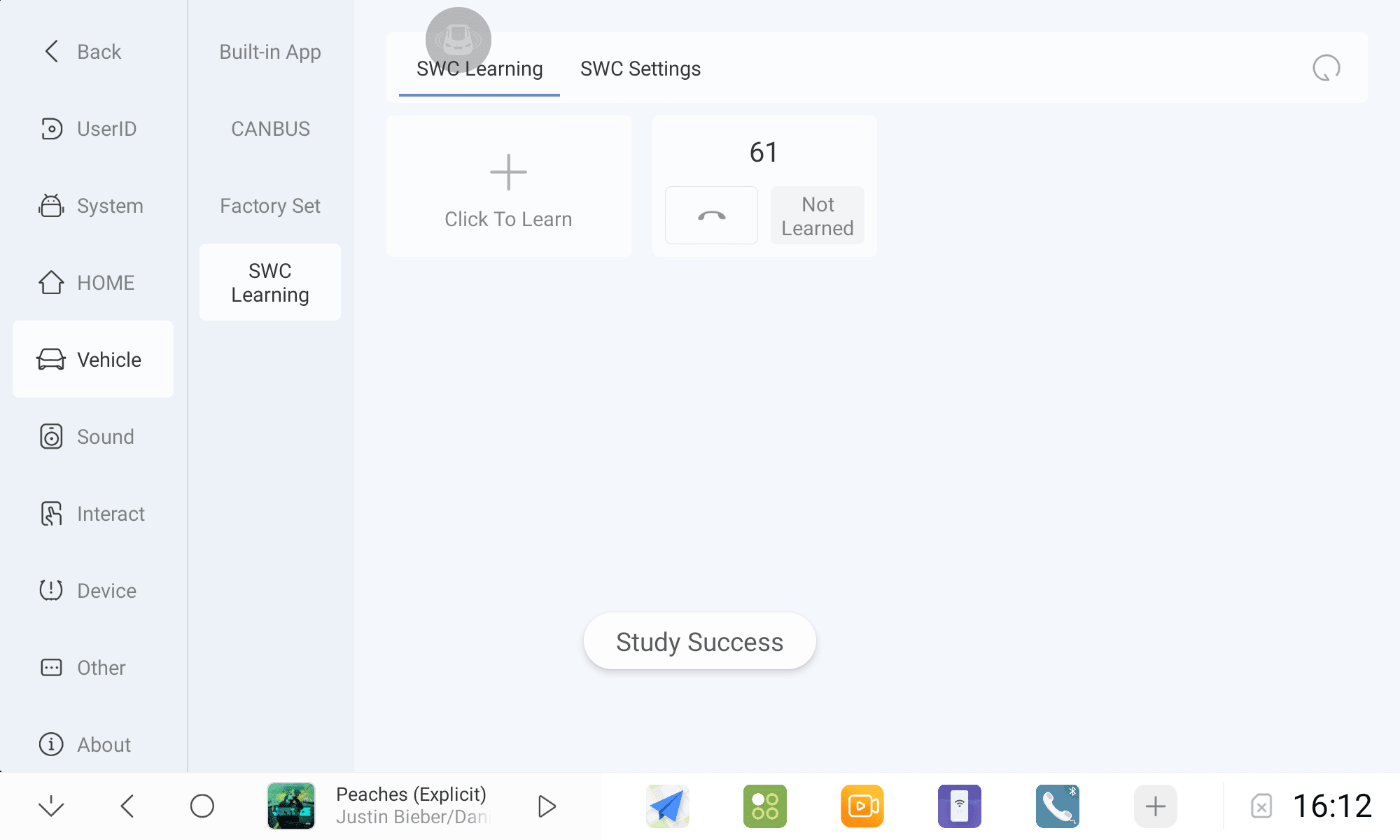

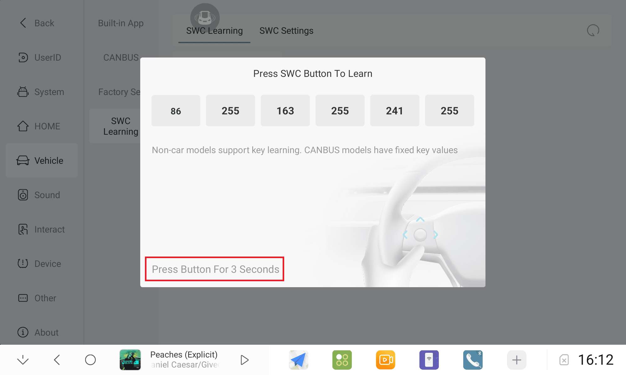

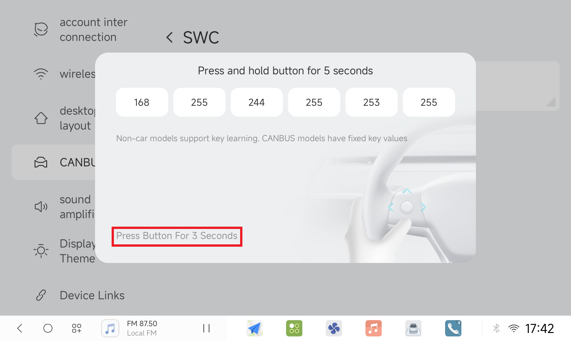

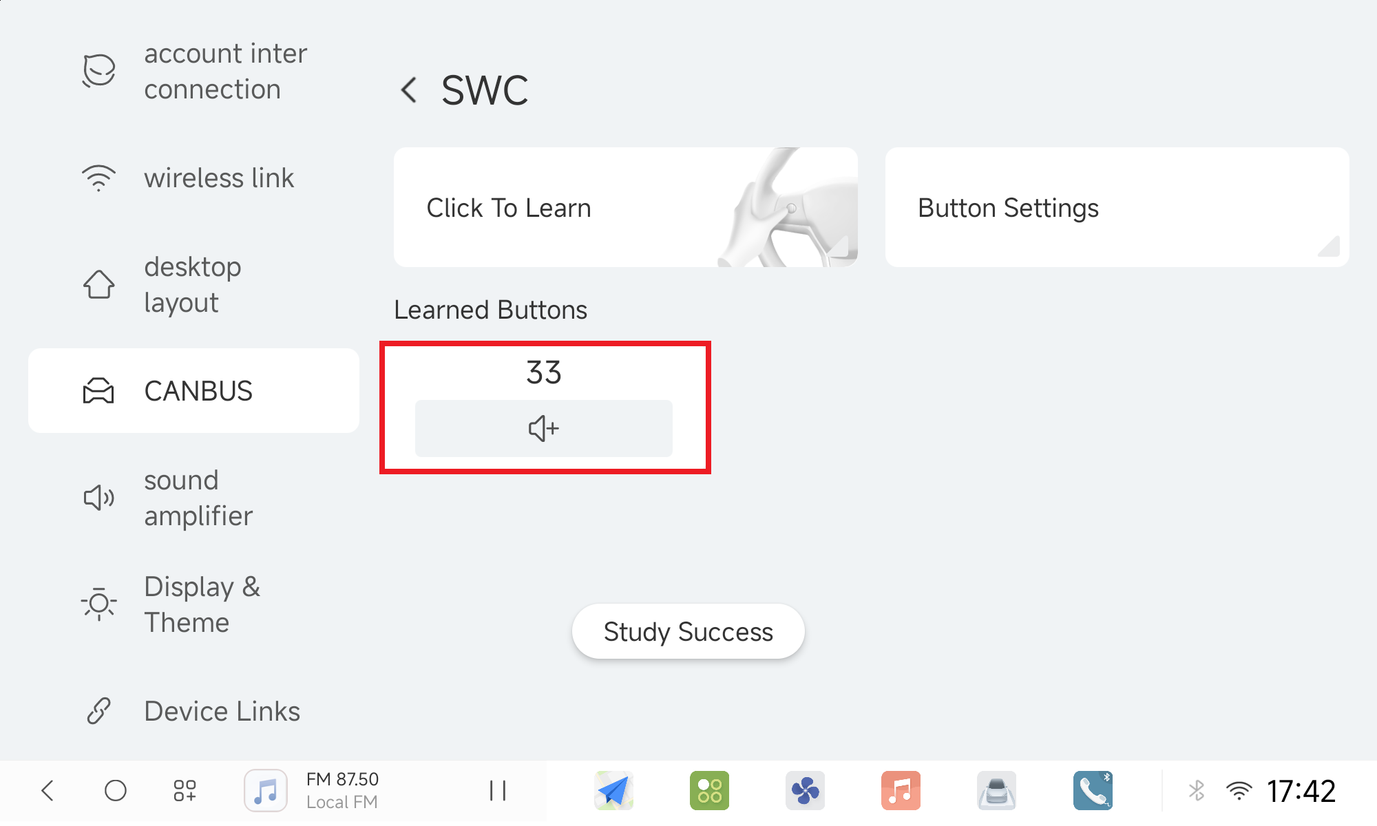

Select the function you want to learn, press and hold the steering wheel button for more than 3 seconds, and the corresponding icon will appear, indicating that the learning is successful.

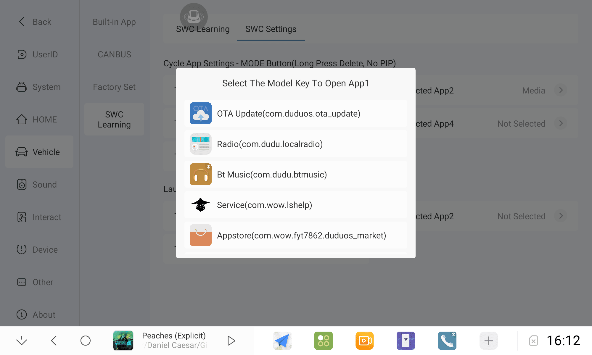

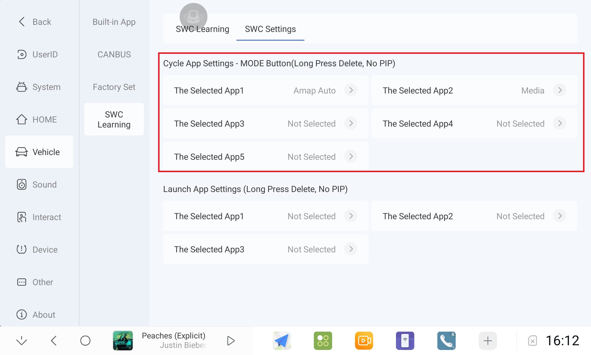

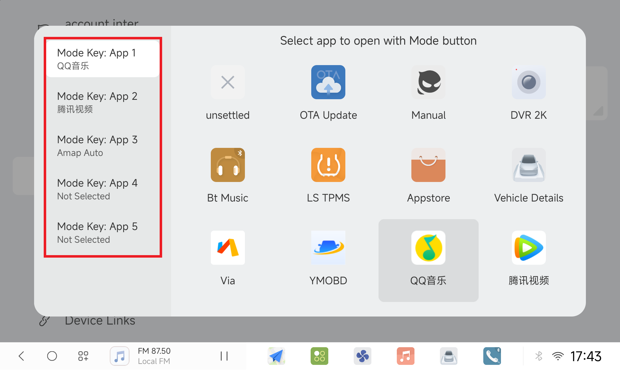

MODE button setting, you can set multiple APPs to switch in a loop (if you need to use the MODE button to open an APP, only select 1 APP)
