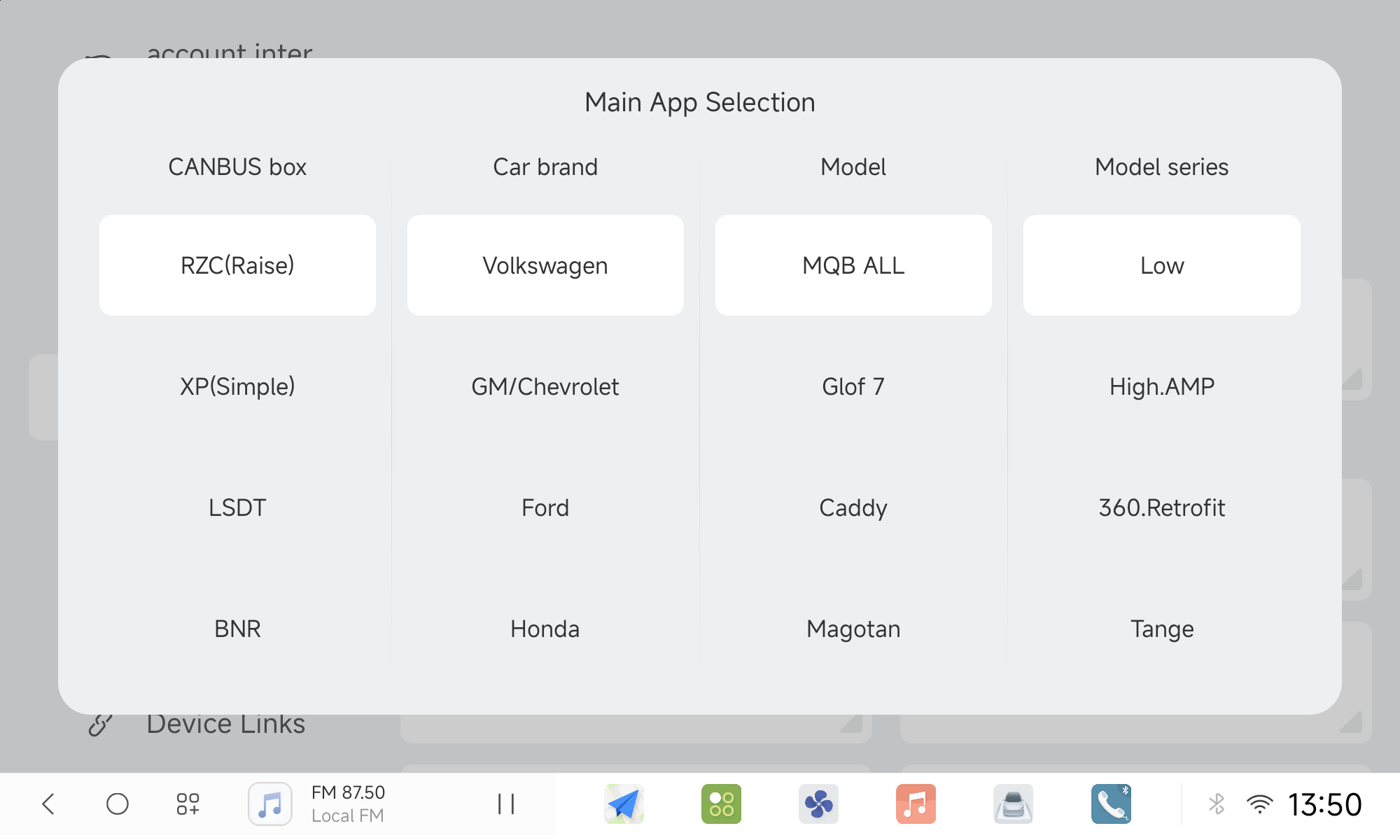

Check the label sticker of the canbus, and confirm the brand of the canbus
【1】Hiworld【2】OD/Oudi【3】RZC/Raise【4】Lz(Hz)/Luzheng【5】XP/XINPU/Simple soft【6】BNR/binarui【7】daojun/Dogen-Electronics【8】XBS/xinbasi

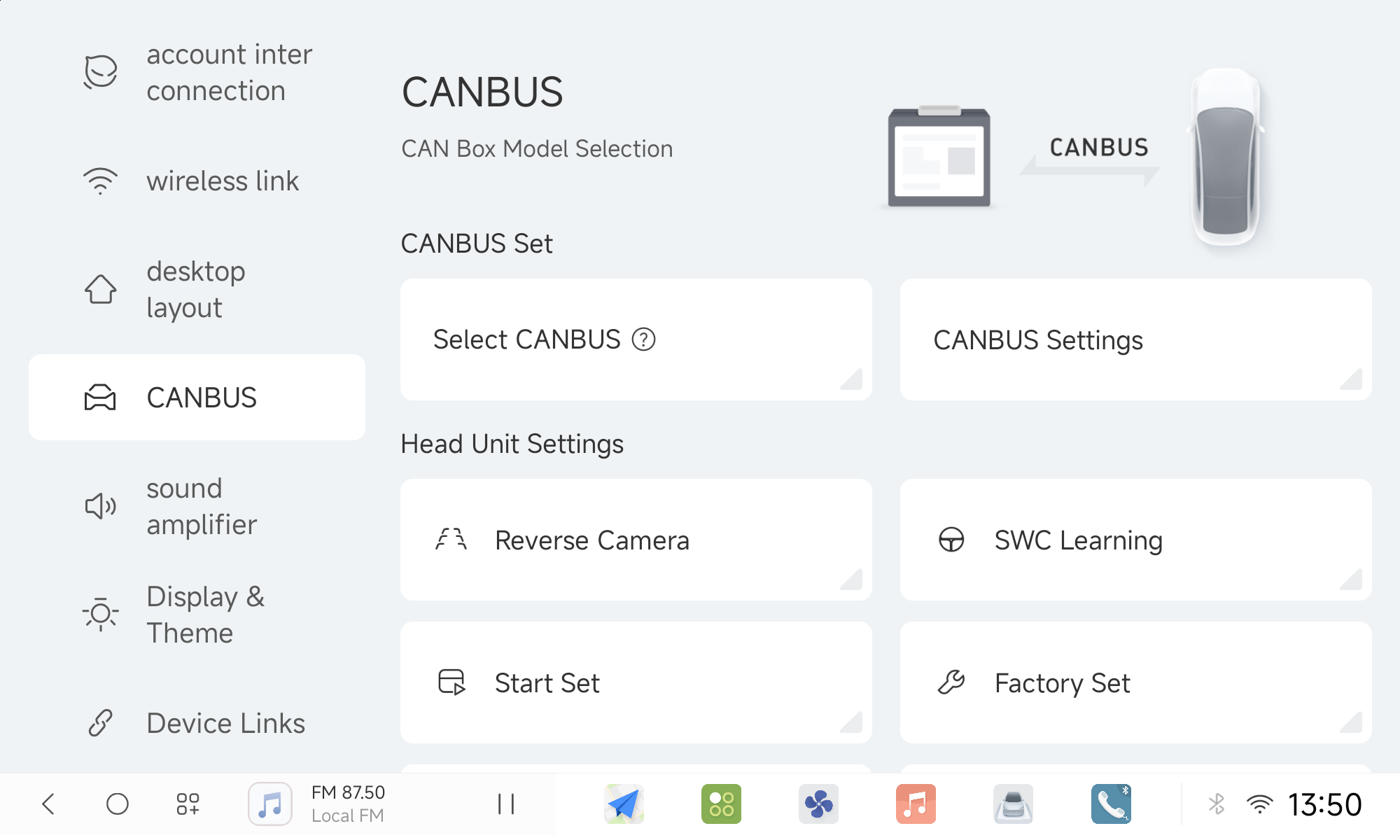

Settings - Vehicle - Vehicle canbus - Car Model Selection
.png)
.png)
