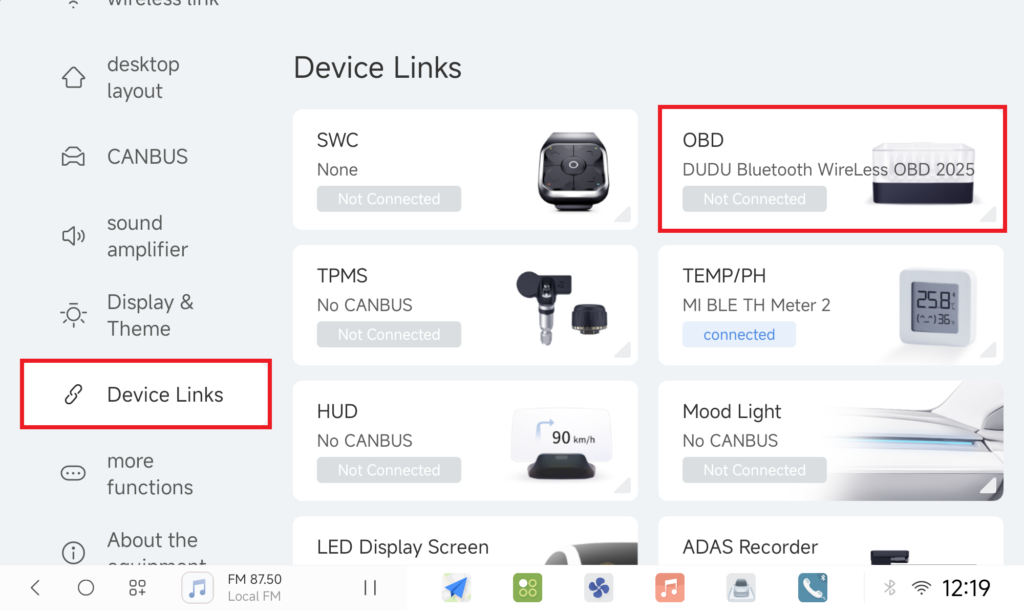

Device connection - select OBD

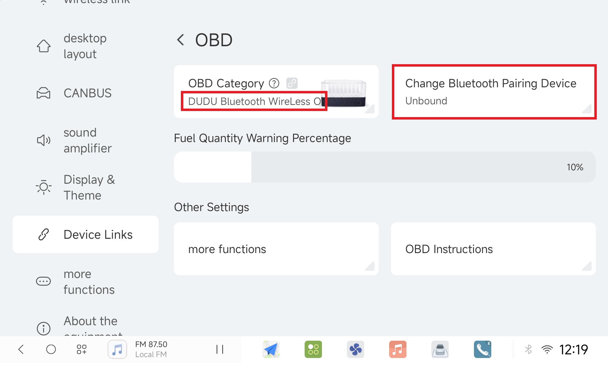

Select DUDU Bluetooth WireLess OBD 2025 to connect your OBD device's Bluetooth

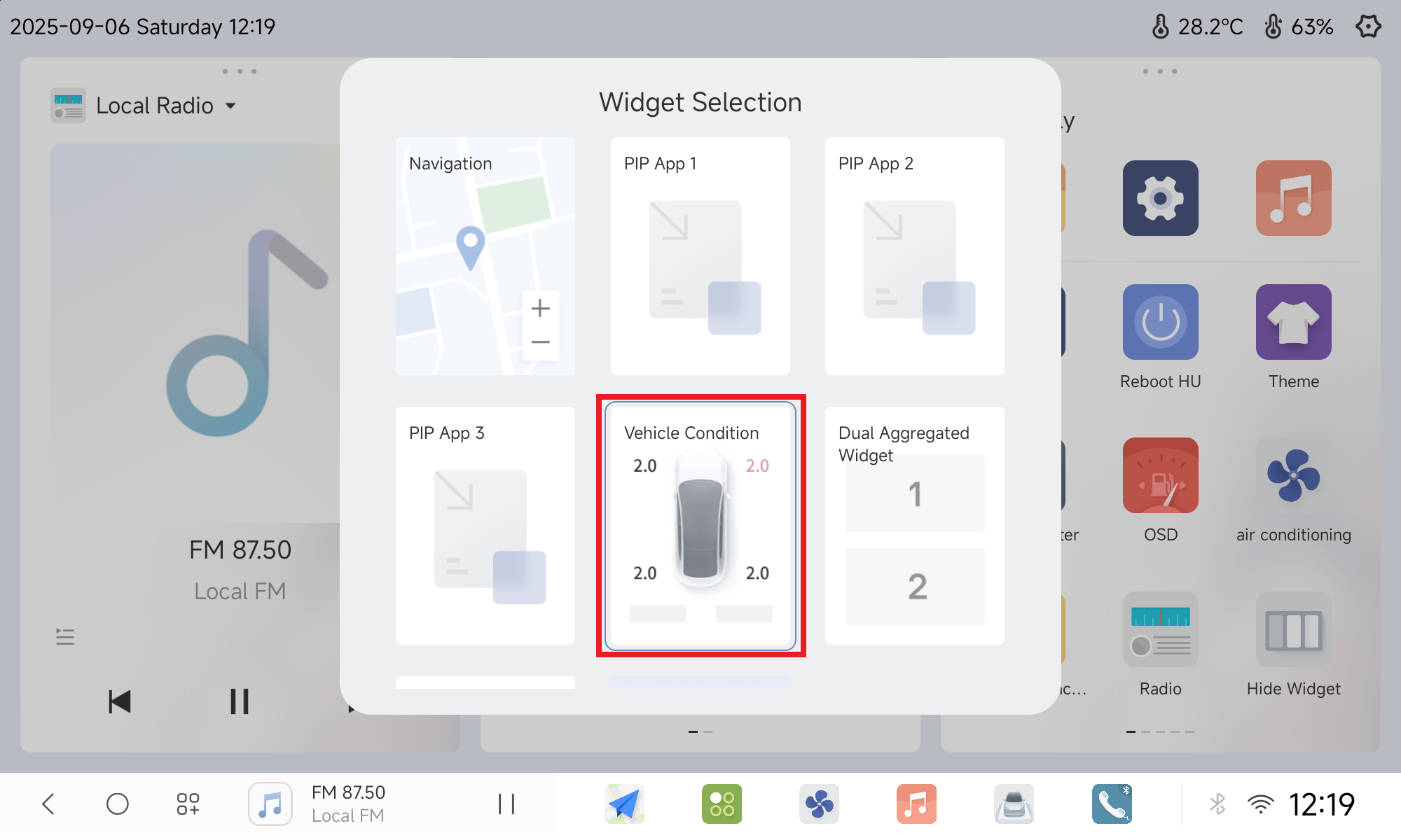

On the home page, click the three dots to select the vehicle status plug-in

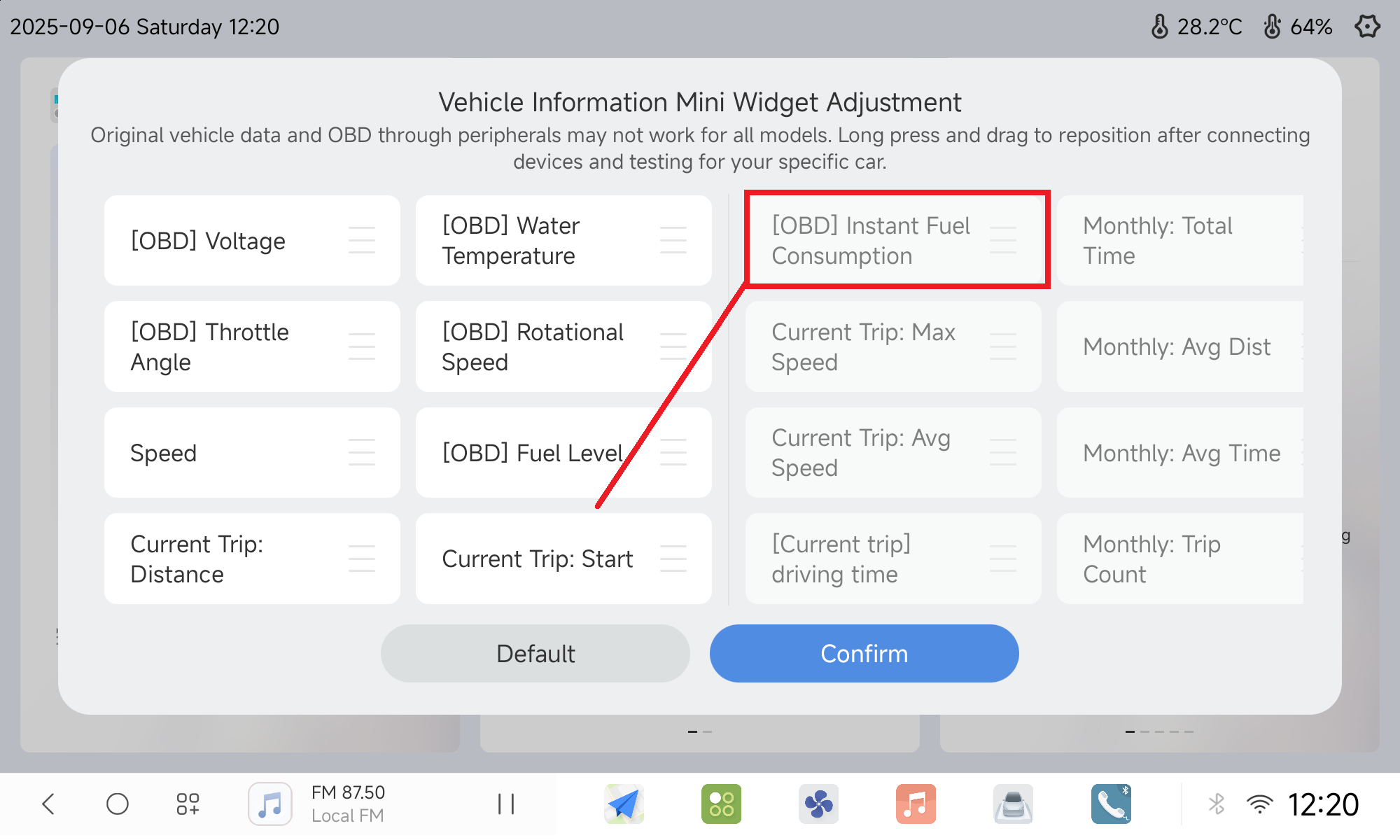

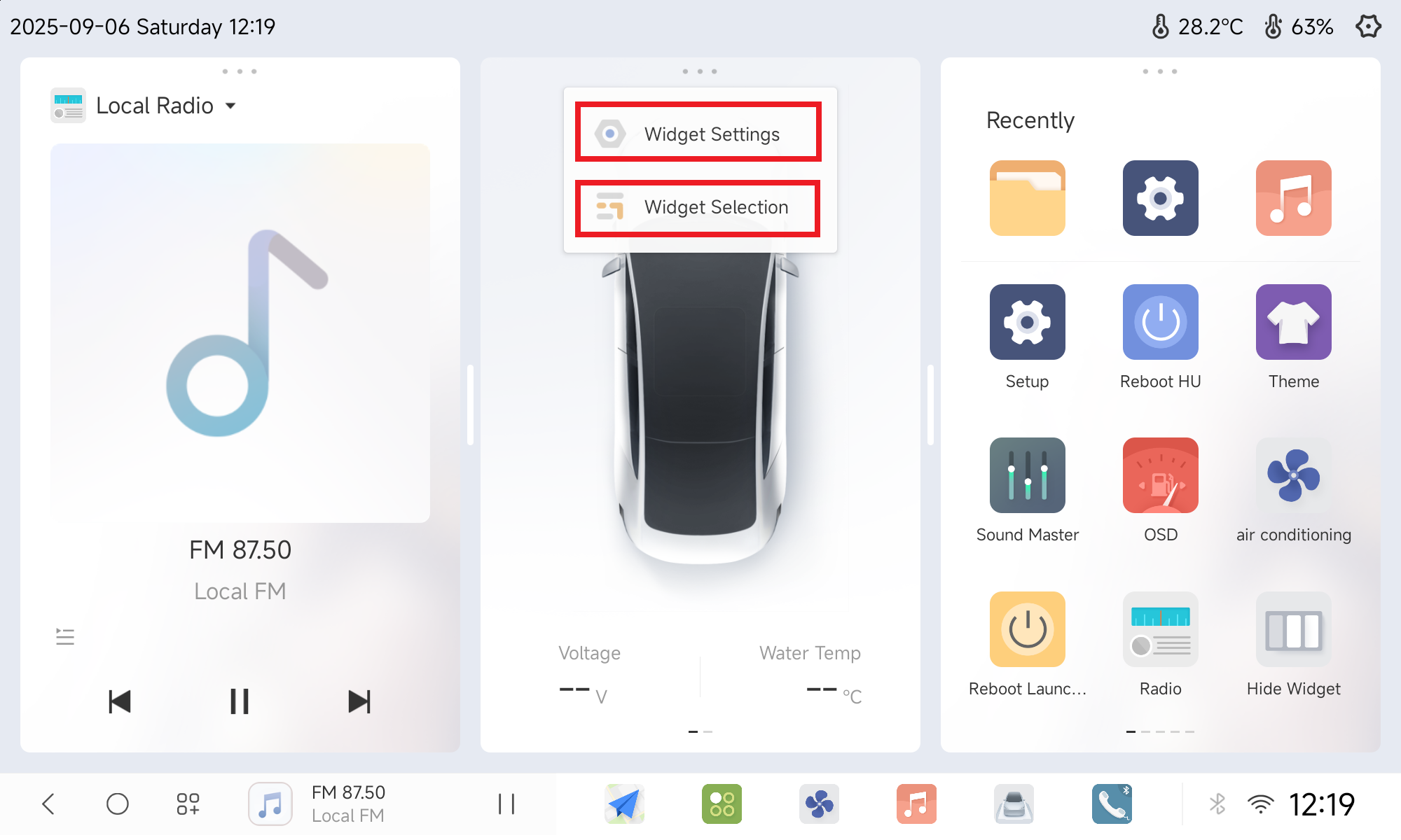

Click the three dots on the home page to set the plug-in and move the OBD information to the front

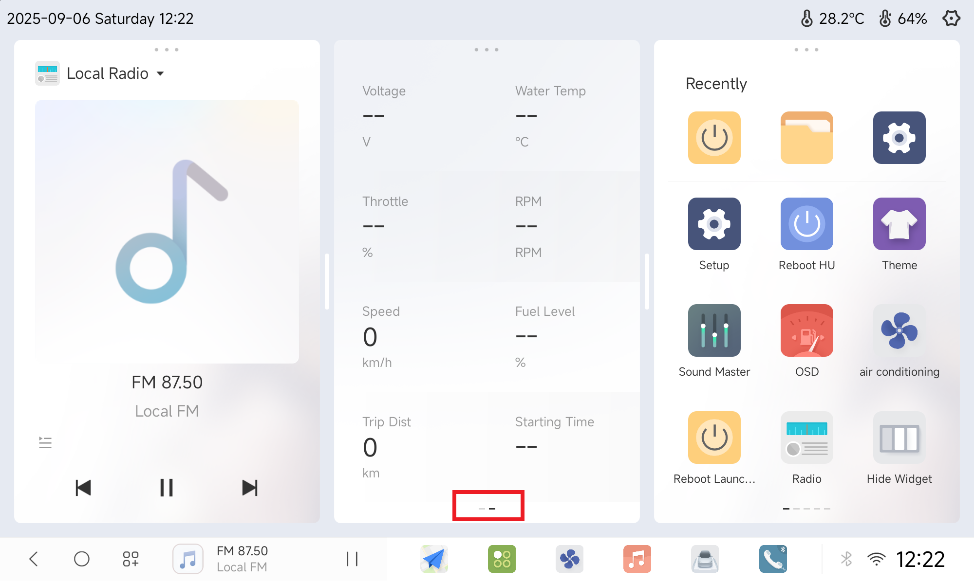

The vehicle status plugin has 2 pages that can display more information
