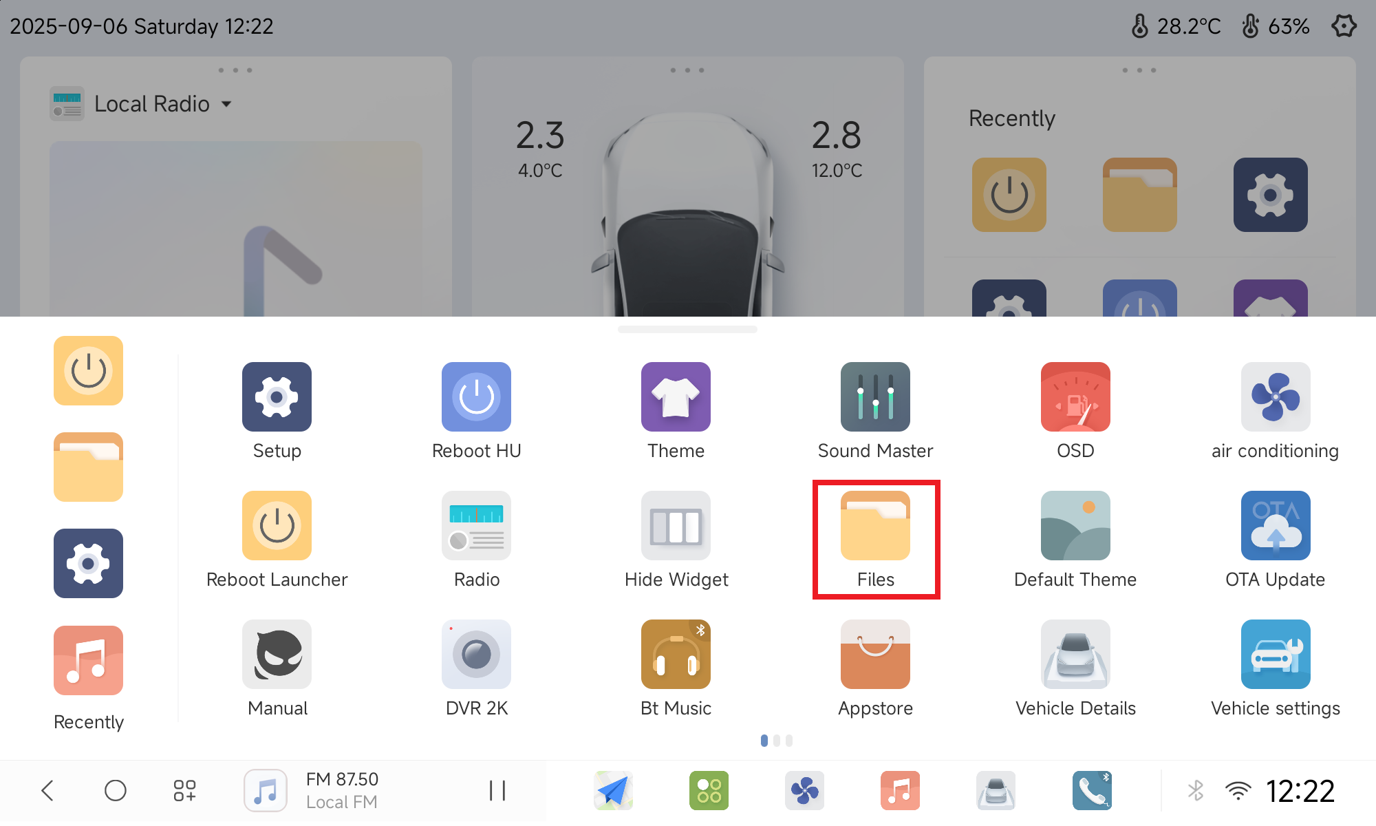

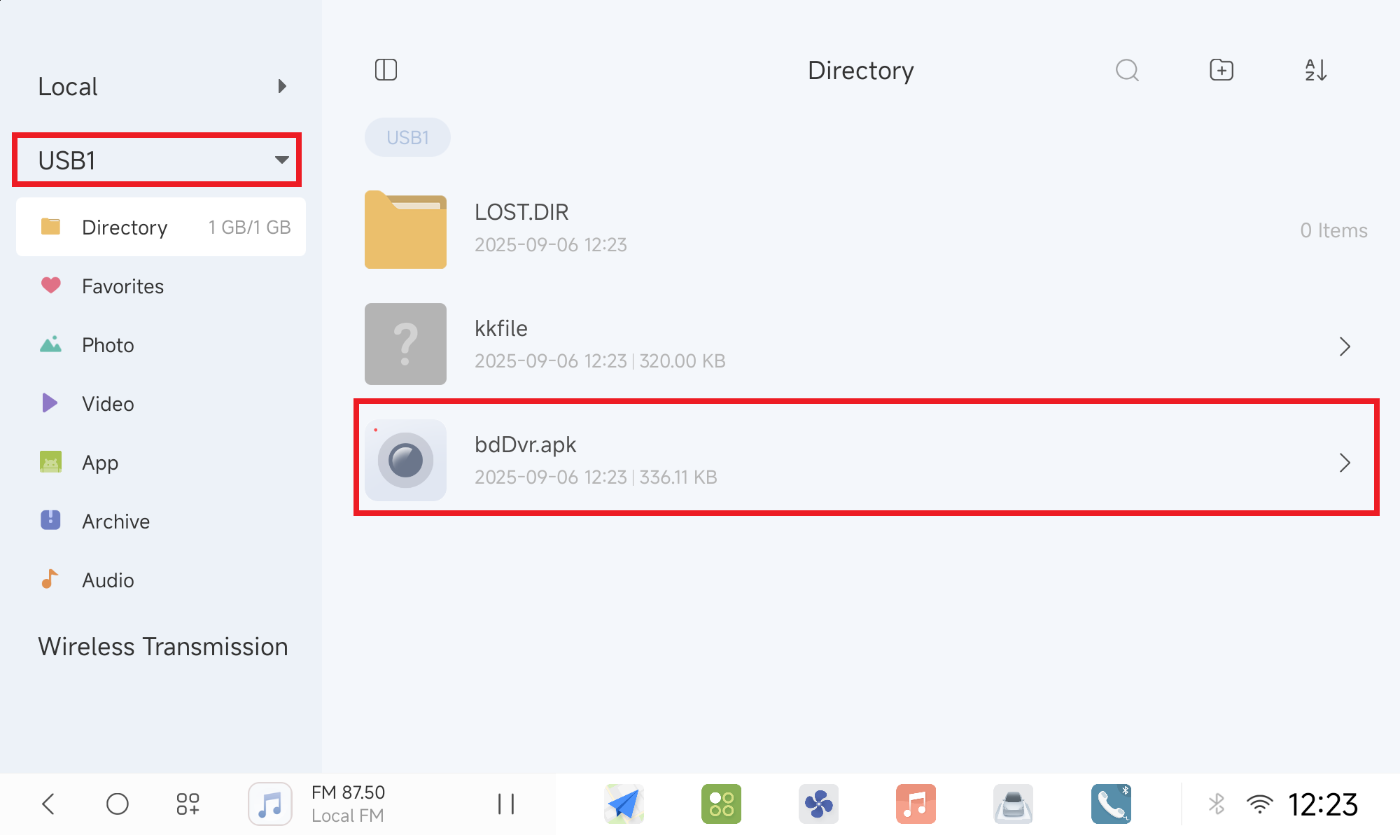

Open File Manager and find the corresponding USB disk.
Click to install bdDvr logger software

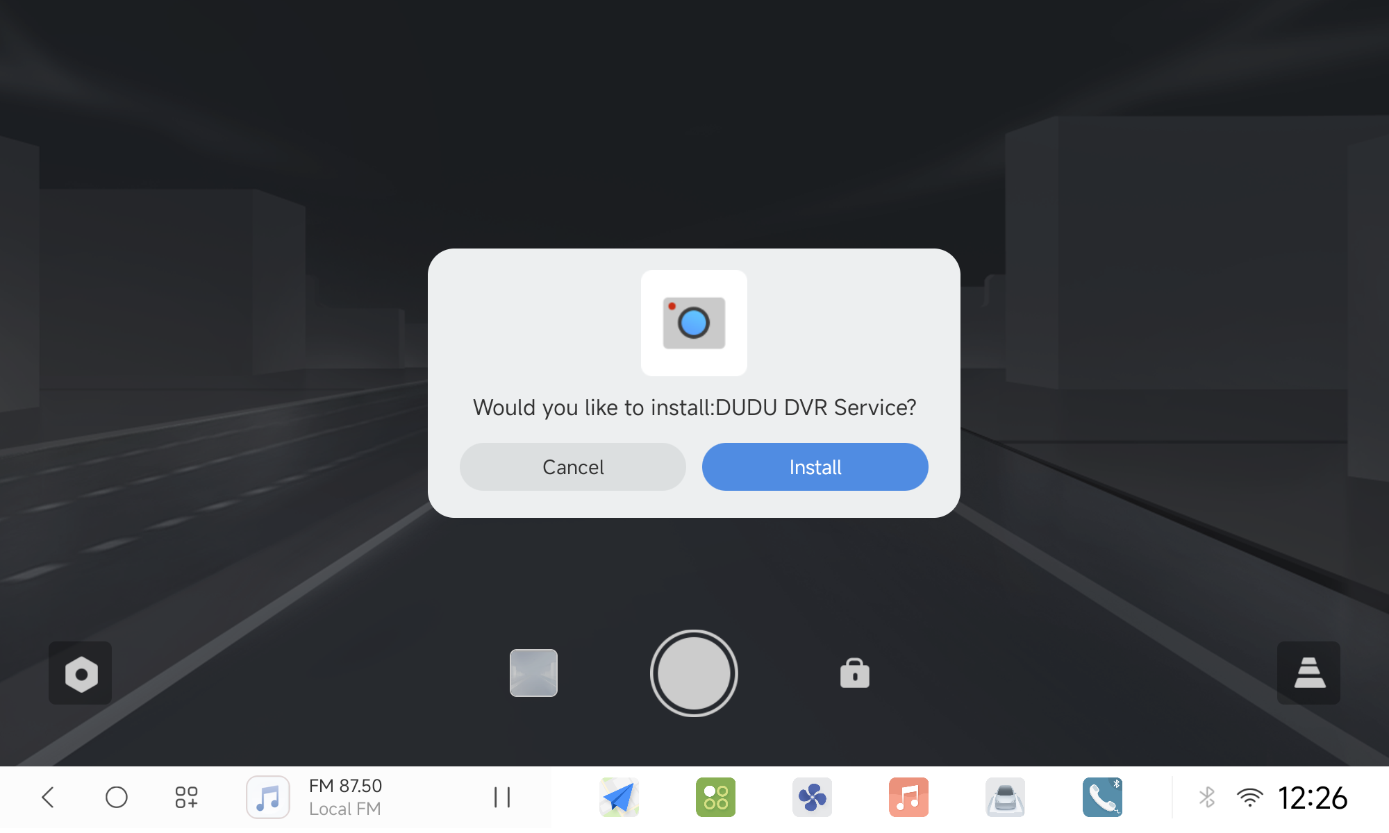

Download the latest version of DVR application and DVR core service online

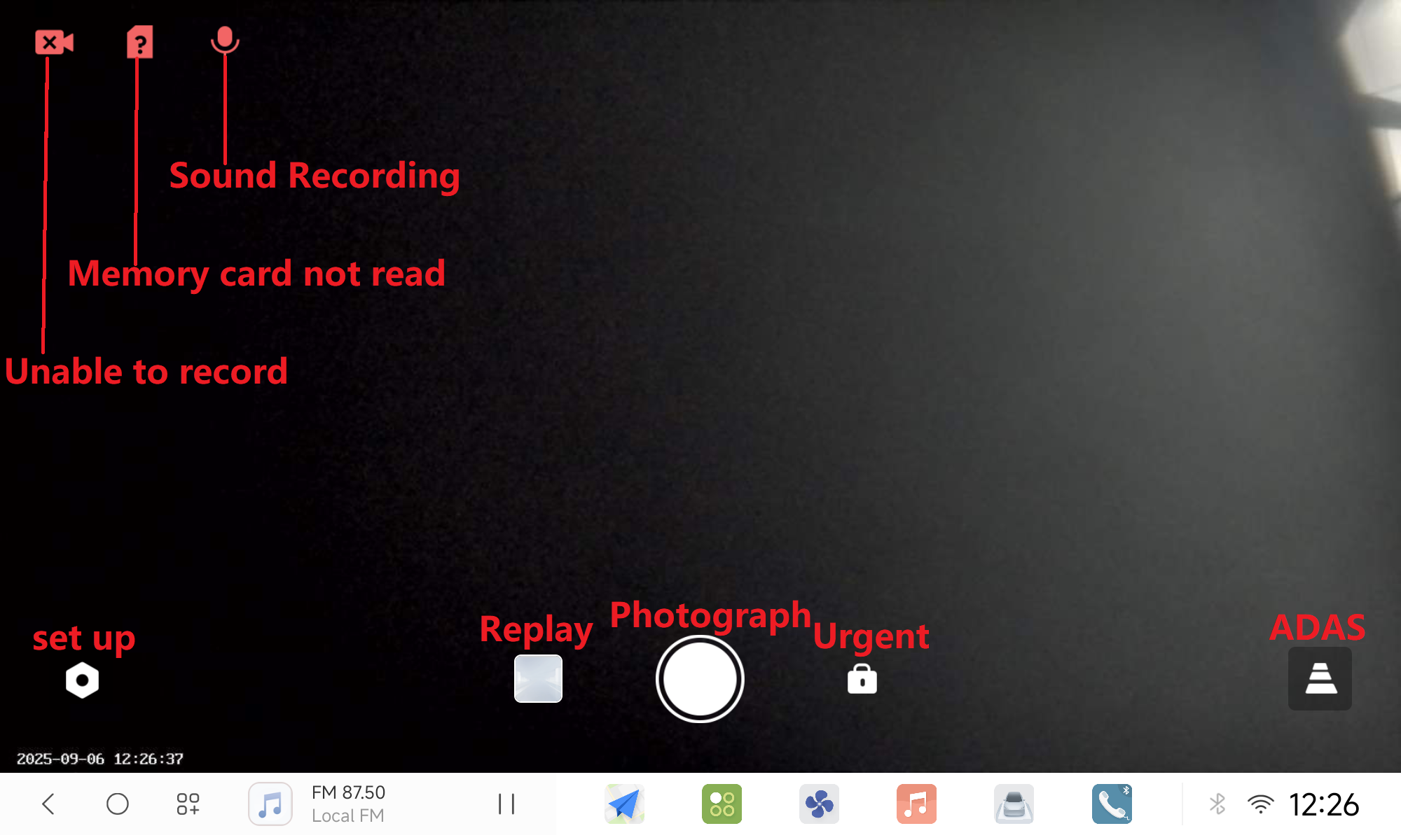

Icon Description

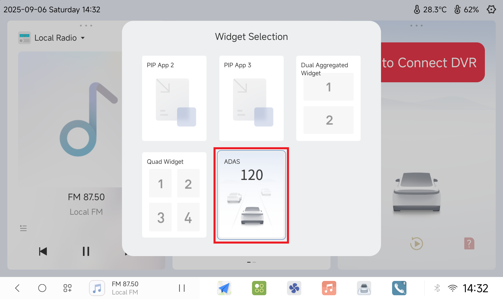

How to set up ADAS on the homepage widget
Click the three dots on the homepage and select ADAS as the widget.

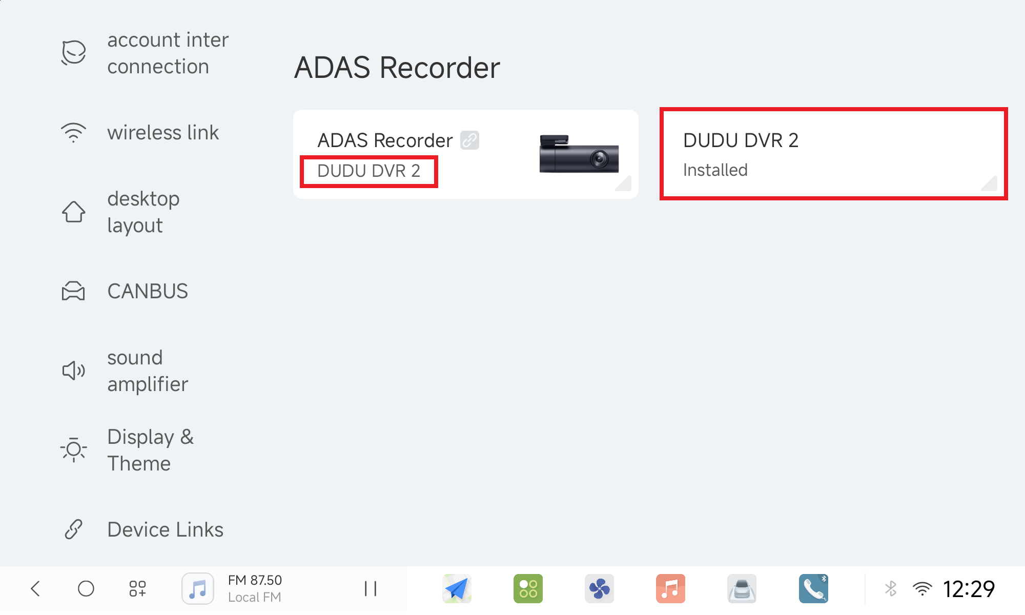

Click the DVR link to jump to the DVR binding interface and select DUDU DVR2 (DVR application must be installed)
