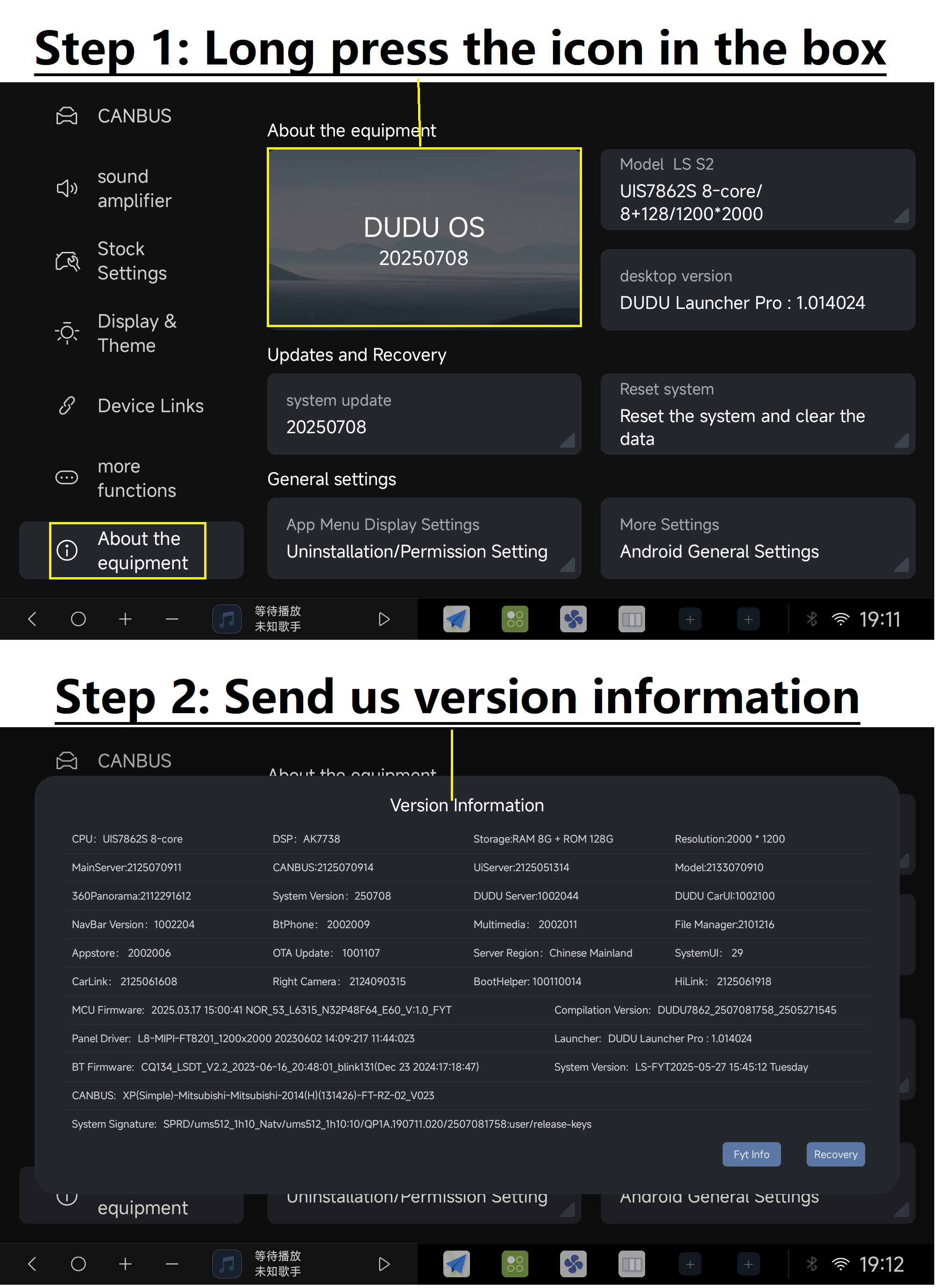

Please take the following 3 photos for R&D analysis and bug fixing:

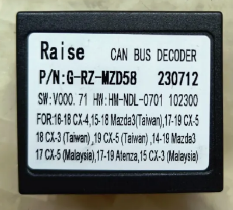

【CANBOX label】

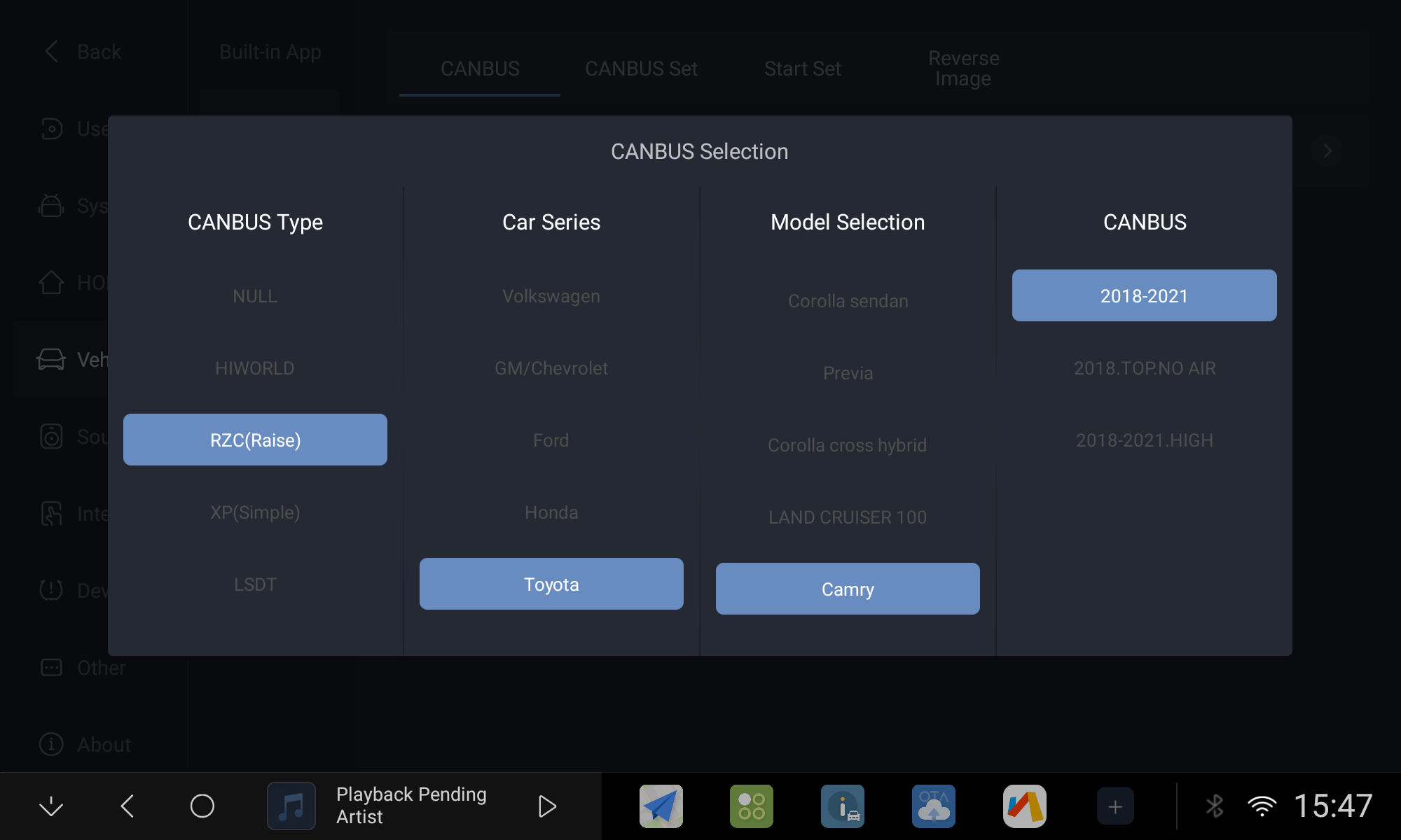

【CANBUS Selection】 Settings - Vehicle - CANBUS - Select CANBUS
【Version info】Settings - About - Hold The HU Image 3 Seconds - Version info

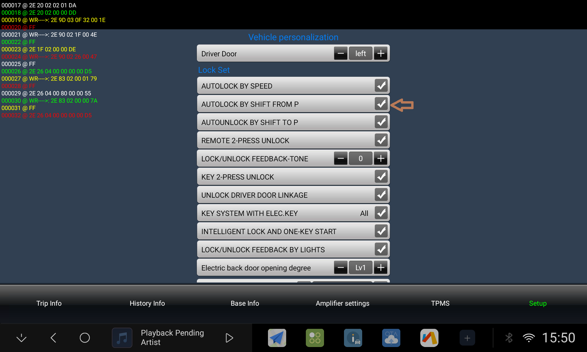

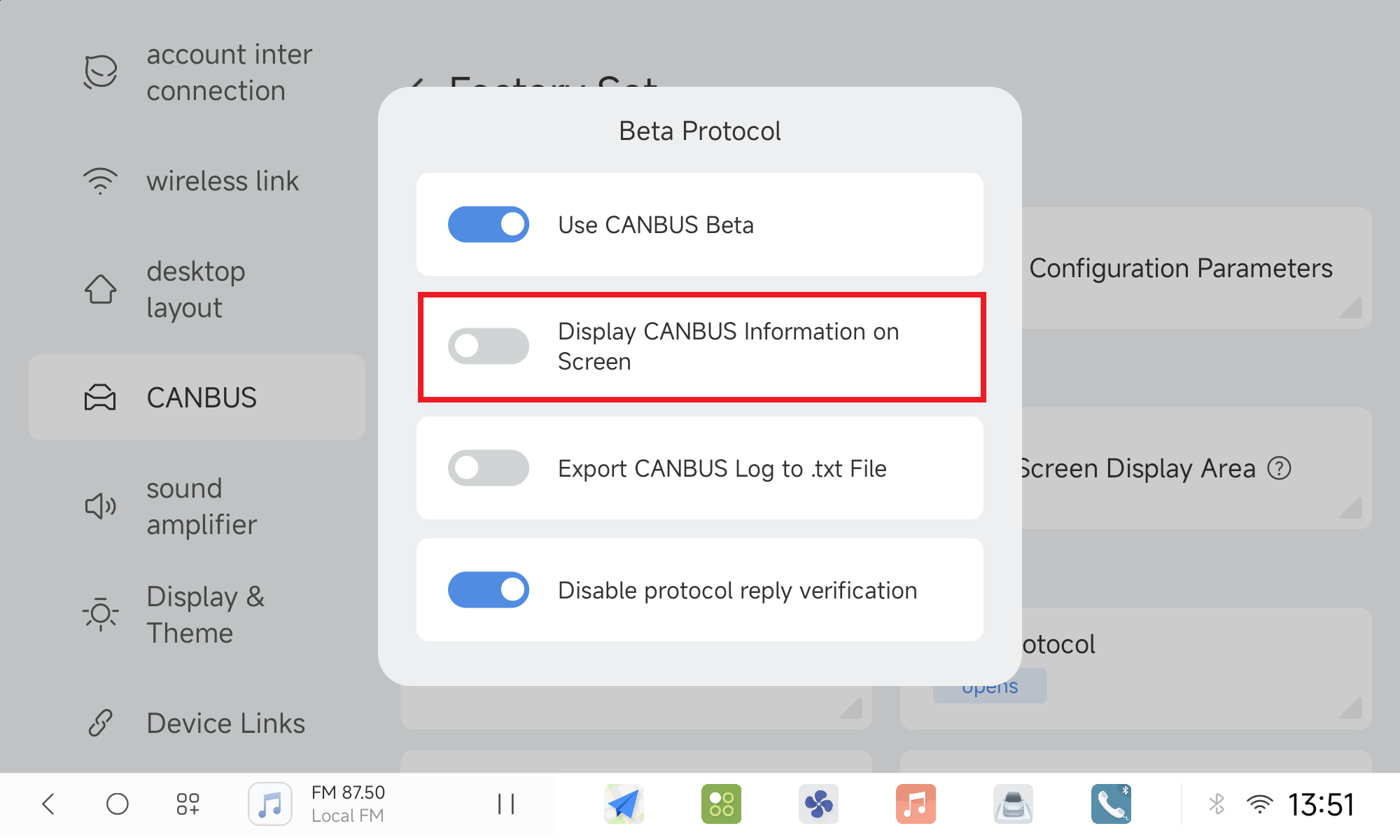

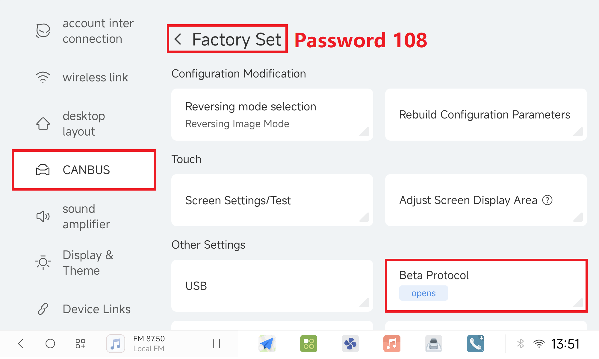

【Display CANBUS Info】 Settings - Vehicle - Factory Set - 【Password 108】 - Other - Display CANBUS Info.
.png)
.png)
